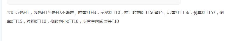

倒车灯是T15.后雾灯是1156,加装需要自己打孔上灯座
发表于 2013-12-22 16:47:02 | 显示全部楼层
倒车是t15   后雾灯我没看过

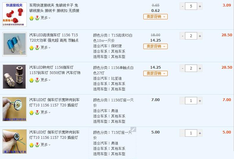

http://shop62185216.taobao.com/shop/view_shop.htm?spm=a1z0d.6639537.0.0.anv1nI&user_number_id=448377331
